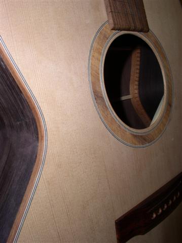

How thick is the burl or other woods you use for rosettes
PostPosted: Fri Apr 01, 2005 9:58 pm
mine starts out about .090 or so. Then its installed into the top proud, then sanded flush.

Your wood rosettes are so beautiful and clean looking!!!
Do you ever use burl wood?
Maybe burl wood is difficult to cut out?
Thanks for the pic's.
Never get tired of looking.
walter
PostPosted: Sat Apr 02, 2005 2:12 am
Posts: 684
Location: Nashua, NH
Walter,
I didn't find it any more difficult than any other figured wood. Just take it slow and use sharp bits.
Lance had a demo of this earlyer and I fallowed his lead.
The center of the rosette and head plate in the forground is cherry burl.
Wade
Nashua, NH
http://www.wadefx.com

Beautiful!!!!
PostPosted: Sat Apr 02, 2005 3:07 am
I find that if you flood the burl on both sides with cyano it helps to stablize it. Set it aside and let it dry for a day. Then cut the rosette out. Good sharp down cut spiral bits work good. Beleive it or not the HSS bits are sharper than carbide.Bobc38444.5064467593

Bob, do you sell would in the size shown above to make rosettes with?
BTW, what type of burl is that?

That's red myrtle burl. I have a lot more differant woods. Just no time to put pic's up.

Lance, how deep is your rout
PostPosted: Tue Apr 05, 2005 1:20 am
about .050 -- same as a typical shell rosette inlay.
